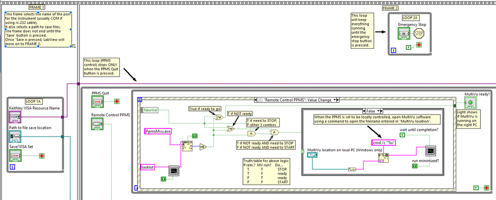

I'm having trouble understanding what triggers a flat sequence to move from one frame to the next.
Specifically, I have a setup that sends data collected inside an instrument with cryogenic capabilities to a multimeter. A VI (credit to Tektronics, NI, QD Instruments, and V. Morano for original code) reads the data leaving the multimeter while controlling both instruments. The issue is that the cryogenic machine (PPMS) is either controlled on its own computer or on the one that is running LabView, and throws a fit if its control software (MultiVu) is open in both locations.
So to control for this issue I implemented a piece of code which 1) checks if the PPMS is set to be remotely controlled, 2) checks if MultiVu is running, and 3) starts/stops local MultiVu if needed. I put this into the second frame of a flat sequence structure, which I'd like to keep so the other users of this VI can better follow my changes.

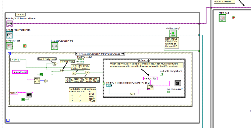

In the second frame (top picture), the starting/stopping is incredibly slow - like 2-3 min between user action and VI response. I think this is because of the other highly complex loops in that frame.

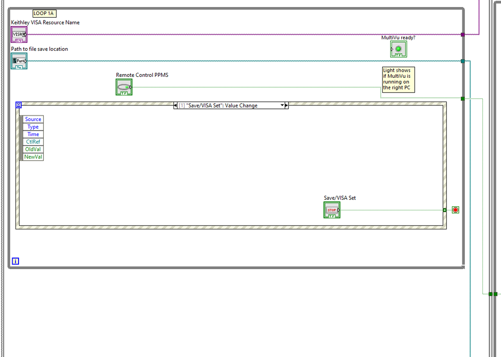

I managed to speed this process up by moving this bit of code into the first frame. Now the open/close is super fast! ...but the VI will NOT proceed to the next frame. I've tried moving controls in and out of loops and frames, no luck.
I can do without this code if necessary, but I'm now confused as to what exactly triggers the progression through flat sequences, and it ma come up later.
So, what is not happening to progress to the next frame in the bottom photo? You can change the "PpmsMvu.exe" to "notepad.exe" to run on your own PC. Cleanup suggestions are okay, but I really only care about the frame issue ATM.
old and slowold and slow
fast but stopsfast but stops

In code #1 Your first frame uses 100% CPU doing nothing but polling the controls. (greedy loop)

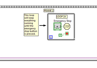

The loop in the second frame (or code #2) can only spin whenever an event occurs. How often does that happen?
You have event structures scattered across the entire diagram, buried deep inside loops inside case structures. Very Bad!!!
Overall, big sequence structures are a hallmark of bad beginner code. Learn about state machines instead.
Do you really need to poll the emergency stop button as fast as the computer allows, also burning 100% of a CPU core that could be used more efficiently elsewhere?

I'm aware of its many issues with loops/case structures, just trying to make minimal changes to preexisting code. I'll go back and streamline after I jump this one hurdle.
Events occur whenever a button is toggled, so theoretically as quick as a human clicks? In the old version there's about a 2 min wait after any click before the action is performed, no matter how rapidly/frequently one clicks.
Are you implying that the old code is slow because the PC is wasting resources on other things? I had already guessed that. Can you help me figure out why the newer version won't execute past the first frame?

To exit the first sequence you have to exit the loop. To exit the loop you must meet two conditions: first "Save/VISA Set" must be true, and secondly the event structure has to execute at least once. I would at minimum add the "Save/VISA Set" button to the event structure.
As altenbach has mentioned there are a lot of architecture problems with this VI however (greedy loops, multiple event structures, data duplication).
Anyway, as a starting point here is a picture of what I recommend.
That's not good.  The resource name, file path, and remote control boolean will all be read immediately upon entering the loop.  The loop will wait at the event structure until the Save/VISA set boolean is pressed and read as True.
However if the user changes any of those controls prior to pressing the Save button, they will not be read since they have already been read when the loop started.  You should move all of those controls inside the event case!

OK, so clearly this event structure within the flat sequence is a failure. I tried moving the Save button within the event structure - this allows the flat sequence to proceed BUT it only proceeds if Save has been pressed and then a change is made to the Start/Stop MultiVu button. Not exactly what I want but I understand mostly why it does what it does.
