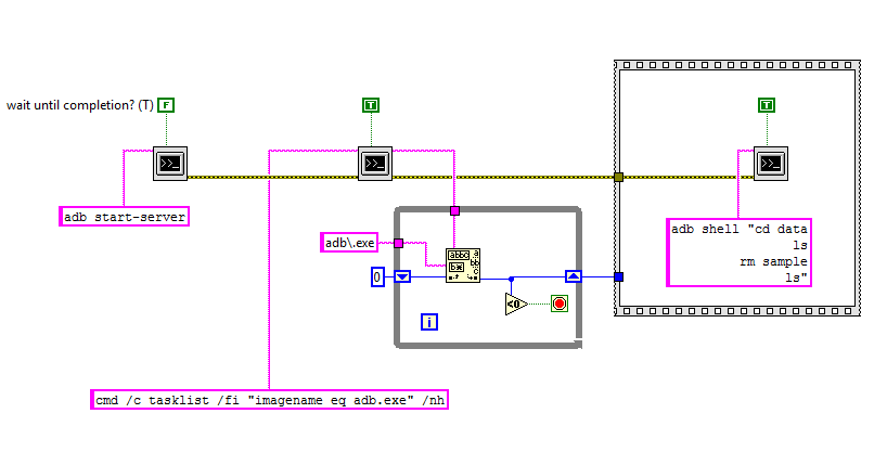

Here's a quick example of how I got this going, not particularly proud of how this went down, but at the end it worked.
- First, launch the ADB server.
- Then, using tasklist wait for the adb server to appear on the process list.  This gets a bit trickey because in the processes list the ADB server and the ADB shell windows have the same name so you see to instances of "adb.exe", and have to wait for one of them to go away so I would know the adb server had truly started.
- Finally, I ran all my commands using adb shell.  If for some reason adbserver went offline and you tried to run an adb shell cmd, ADB would automatically try to re-start the server and get stuck forever (you'd have to run "adb kill-server" from a separate window to exit, 'cuz abort doesn't work in this case).  If you are running quick / manual tests it's no biggie, but if you running hour long scripts, then I'd suggest making sure adb server is running before using any other adb command.
