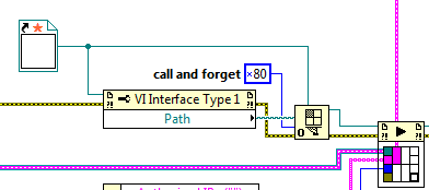

If you can, I would recommend dynamically launching the VI like this:
The static VI reference will make sure that the dynamically called VI is in the main VI's hierarchy at compile time, so shouldn't require any additional inclusions.  Set the VI reference to strictly typed for the correct connector pane interface and also use the reference to get the path on disk from a property node.  The path will update correctly regardless of whether you are running it in development environment or run-time engine.

Thank you for all your helps !!
I include Vis in "always include" and set some additional exclusion (look the pictures).
I get the error 1003 after the block "Open VI Reference Functions" but the path it's correct.
i use the code in Figure 3 for the VIs path.
Is the static VI a better solution ?
How can i call N subVIs with Static VI solution ?
Thank you

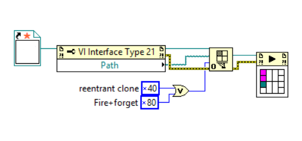

I usually launch N VIs using something like this in a loop.
In this example, I don't expect expect any data back from the VI (not through its connector pane anyway, I give it some queue and event references, so it communicates over those channels..
I think option 0x100 rather than 0x80 is call and collect.
When spinning up clones like this (especially as fire and forget) I usually include some "self killing zombie" code in the launched modules.
If the module detects that the main VI has stopped, the module will suicide itself after a short delay. Nothing worse than a zombie infestation.

If you will only call 1 VI (even if just clones of a single VI), then I would go with the Static VI Reference method.  It just eliminates a lot of complications that you are running into.  Just drop a Static VI Reference onto your block diagram and then drag your VI into it.  You will probably then want to right-click on it and choose "Strictly Typed VI Reference".
