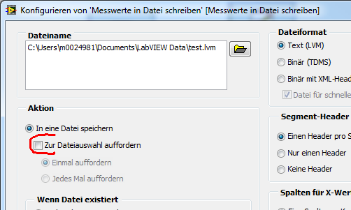

Hi Jalashwa,
well, I also use the German LabVIEW version… 😄
(You will find the English LabVIEW help on NI's website so you could read the help in two languages! ;))
This is (a part of) the config dialog for WriteMeasurementData ExpressVI:
The red marked boolean input dis-/enables the file dialog of the WriteMeasurement-ExpressVI. You enabled the file dialog - and then wondered about the second file dialog…
