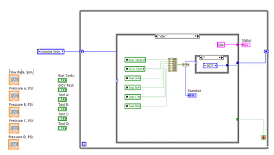

I'm still figuring out state machines - and Labview in general, but I've uploaded my VI here if anyone wants to check it out.  I don't have any actual tests programmed in yet, but I am close to getting the test sequence dialed in.
Basically, the way this VI works right now is you select the tests you want to run then hit "Run Tests" and it cycles through the tests that you selected.
It works ok, but I am having trouble with the data flow inside each case structure.  Currently, the VI shuts off the test button (ex: Test A), waits 2 seconds, then displays the status string.  How can I control the data flow so that the status is shown first, then the wait, then the light turns off and finally the case structure goes to the next state?
Nick
Nick
I can't open your vi because I've not yet moved to LabVIEW 2021. It's usually a good idea to save code for a previous version (usually 2 or 3 versions back) when the code is not dependent upon features of the current version.
To answer your question though, you could have a state that is "Update status," another state that is "waiting", another state to turn off the light, etc.
