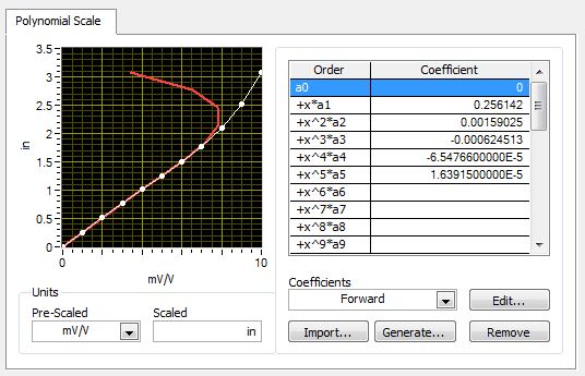

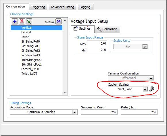

What I'm having an issue with is a second functionality the user wants to have available to them. They want to be able to see the coefficients in a polynomial calibration while the VI is running so they can make sure the calibration is up to date. Even more helpful would be an indicator for when the device was last calibrated, but that is secondary. The problem is that the calibration in this case is done in the Custom Scaling part of MAX, as shown below in a few screenshots. Capture.JPG
^This is the information I want displayed on my LabVIEW front panel.

One thing is the calibration and another the scales, in that screenshot you are setting a custom scale to calibrate the device independently if it has been calibrated or not.
You can use the self calibration in MAX, check the images I attach from MAX to see the calibration dates

Thanks, but I'm trying to avoid using MAX here. I want a standalone VI that sets the scaling coefficients from that program. I actually figured most of it it out on my own. Here's what I've got:
It tries to set the coefficients of an already-existing scale, and creates one if the scale doesn't already exist.
