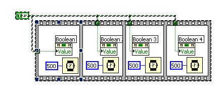

In the attached picture inside the red circle is where I need help.  I'm trying to turn on 4 relays, it currently works but all the relays come on at the same time I need a 500ms pause between each relay and I can't seem to figure it out.  I would assume some kind of for loop would work I'm just not sure how to index the "Fan 1 switch", Fan 2 switch","Fan 3 switch", Fan 4 switch" into an array.
Any help would be much appreciated

Incorporate the Elapsed Time function into your loop, and set it to 0.5 seconds.
Use a numeric indicator to keep count, and use the count with Case Statements and the Elapsed Time to control your relays.
(You could also check out the example for the State Machine wich would also work.)
You don't say if you want only one on at a time, or all four on at once after the 2 seconds.

Hi rocksolid,
try to use a state machine for that. One Case is the 500ms wait time and the other 4 are to switch on the relays.

I'm running version 8.2 so I can't edit your program but I think this might be a good application for a sequence structure.
See Below

Here's one example, using just a numeric indicator as the state control. The State Machine is only slightly more involved.
This example also shows one way to use an array to set your booleans to True/False.

Tom,
I tried what you suggested, but it is weird because the swiches on the front panel work correctly but the actual relays don't turn on until all the ones on the front panel are done and the the relays all turn on at the same time...any ideas?

That's because execution won't leave the thread until the sequence is done. So that is not a good method in this case....SORRY!!  LabView Guru's solution should work.
