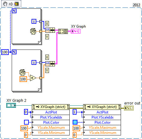

You don't want to have to sort through my whole program, so here is a picture of the state that processes the graph setup. I amusing LabVIEW 2010.

Alright, an update: I have determined that labview is plotting 1 x value and two y values as the same plot, which is why no matter what I do it affects "both" plots. I need to use the plot buffer to plot my data points every iteration of my loop. How can I convert this to two plots? I tried wiring each cluster to its own buffer, and then combining the buffers through a cluster to the XY-Plot, but it didn't take. What is the proper way to do this?

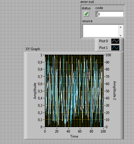

Hi Nukem
Here is a snippet of how you can do this, the answer was in another forum “Right click on the existing Y scale and select Duplicate Scale.  You will then have another scale which will show up in the properties dialog.  Unfortunately, this is the only way I know to create a new scale”
Regards
Esteban R.
