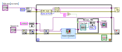

Hi! I'm having troubles with this little program and cannot find a solution, anyone have a clue?
So it's really simple, I just have an arduino with a button and I want labview to read that data and store an image whenever that button is pressed
The arduino program is this one
int boton=2;
void setup() {
  pinMode(boton, INPUT);
  Serial.begin(9600);
void loop() {
 if(digitalRead(boton)==HIGH)
 Serial.println("1");
delay(200);
And the labVIEW connections are this:
The arduino works perfect, just sends the ''1'' character to serial monitor in the IDE. But the trouble is that the case structure never gets a true value... If anyone could provide help I'll very much appreciate it.
Thanks!

I see you are using "Bytes at Port", I suggest you watch this video: VIWeek 2020/Proper way to communicate over serial

Hi Zuz,
int boton=2;
void setup() {
  Serial.begin(9600);
void loop() {
delay(200);
So your Arduino only sends "1\n". And it sends that string only when the button is "HIGH"…
I recommend to send "0\n" additionally when the button is "LOW". Otherwise the message receiver need to handle timeout errors to detect the 2nd button state!
