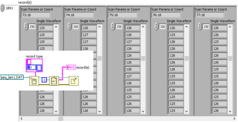

The only hard part is knowing the record type, which you apparently do, so try something as follows to read all 11k+ records.
Note that there seems to be some corruption in the last two records. (LabVIEW also needed to update the file format)
