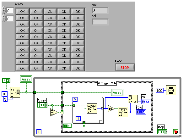

Well, you just need to scan the array to find the row/col of the button that got pressed. Here is a crude way to do it:
It uses a local variable (which I know Ray hates Smiley Very Happy) to reset the array to all False. You could use a "Value" property node just as well, though it's slower. This simulates the pressing and automatic depressing of a front-panel button.

Thank you very much! Smiley Happy
Now I know how to do it the old fashioned way. Smiley Wink I'm used to text based programming, and this is quite a different way of thinking. Sometimes I run out of "fantasy" so I guess thats why I went for the Event structure at first. But I agree with you, I need to solve the problem with the tools I've got. Smiley Happy
Again, thank you.
