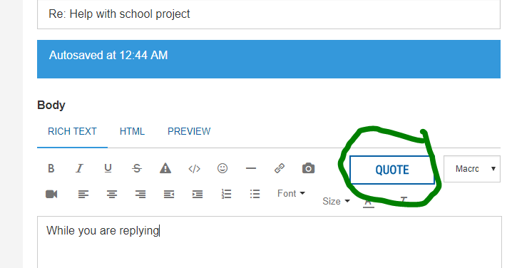

Also, how do I quote something?
Message 8 of 22
(6,257 Views)
While you are replying
