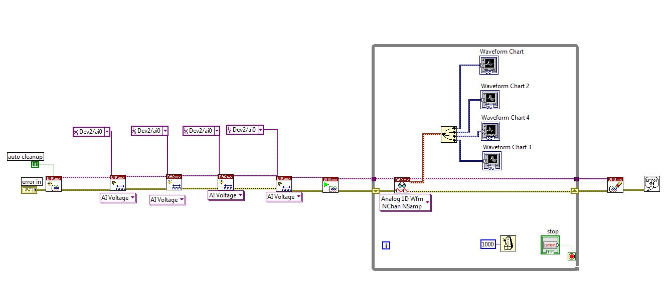

We use the NI USB-6361.
I need a multi-channel system for measuring voltage displayed on the chart, and then measuring the humidity, which will depend on the resistance.
Need 8 channels.
As long as there is such working hours:

You have the same channel for all. Why? You can use a single configure channel and specify multiple channels with it. The syntax is simply dev1/ai0:7. Then use an Index Array instead of the split signal.

you also need to identify how you calculate the humidity from the voltage? Now you daq is a multi sample measurement, you should also decide your timing: software or hw timing, and required rate? I guess for slow humidity sensors you do not need fast daq, just read out 1 sample per channel and put a 100 msec wait timing in your while loop. So you will get 10 samples per second per channel. Use a pointbypoint mean function with sample length 10 to smouth your sensor noise. I would go this way in this case...
