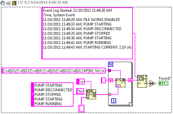

I used a loop to generate the larger regular expression needed to find your terms:
A more general regexp might be sufficient.
Jim

jcrmody,
right what I was lookig for thanks a bunch for your help.
