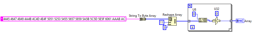

There is not a 24 bit data type so you will need to store it in U32. You need to "pad" your data to get it to fit right.

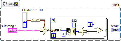

A very similar approach but using an array of clusters of 3 U8, from this thread a few years ago:

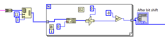

Thanks, Omar. You are correct that I was simply showing hex display. This works well except I cannot figure out how to make the output allow signed number representation to allow for negative numbers. I have tried changing the type into typecast to I32 but no luck. Any ideas?
Message 6 of 9
(8,709 Views)
Nevermind, had to change the output array of course! Thanks

Are you sure that's working for negative numbers? You should need to sign-extend the 24-bit value to 32-bits, which won't happen with Omar_II's code. That is, to get a negative number, the first 9 bits will need to be 1. In Omar_II's code, that will never happen. The first 8 bits will always be 0. That's the reason for the slightly more complicated logic in my code, with the x2^n function - it will preserve the sign properly.
Message 8 of 9
(8,689 Views)
Ah right, I did have to add the right shift after the type cast as well. Forgot to mention that in my last post.
