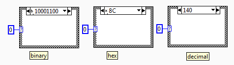

I can't open your VI so this may not be completely applicable.  As crossrulz mentioned, you can change the radix of numeric controls.  You can also do the same thing on case structures by right clicking the case selector.
