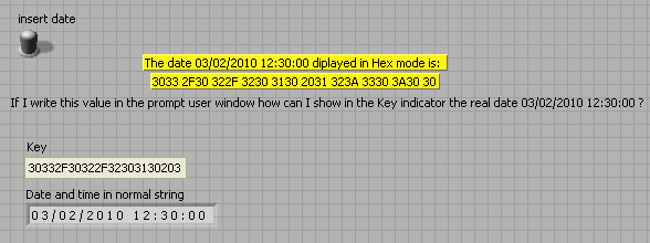

Hi All
I have attached the example
Message 5 of 21
(7,092 Views)

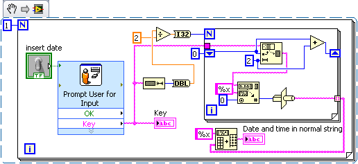

This is the beginning I have made.
There are two  drawbakcs:
1. No spaces in the input HEX code available.
2. The result is given with a space between every character.
This is how it looks like:
Maybe this will give you some ideas while moving on.
Message Edited by Giedrius.S on 02-04-2010 04:53 PM
Message Edited by Giedrius.S on 02-04-2010 05:00 PM

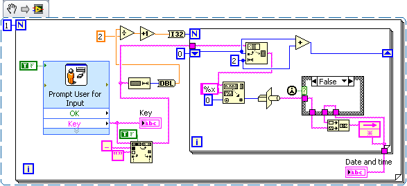

My solution with no drawbakcs.
Anyway, it is very possible that there was a more efficient way to solve this. While I am only a novice, this is the best what I have managed to come with 🙂
smercurio_fc,
No, I have made those changes to simplify the execution for testing the program. Originally, while loop was given.
Message Edited by Giedrius.S on 02-04-2010 05:42 PM
