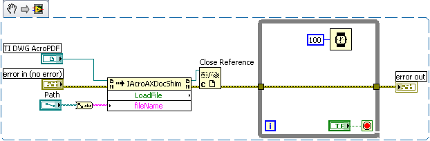

 -  I've designed a VI which displays a pdf file in the ActiveX container (see attached) using LabVIEW 2009 Proffessional SP1.  I'm running in Windows XP, and I've got installed Adobe Reader 8.

Hi Greg.
The fact is that the code you can see in the image attached is the second version that I try.  In the first one, I had done what you suggest, to close the reference.  In this first version is when I found this problem.  Trying to find a solution, I decided to try this second version (removing the Close Reference block and leaving the reference open), just in case the crash was due to interaction with the ActiveX control when the reference had been closed.  No luck.  Both settings make my application to crash.

Well, that seems like a definite LabVIEW bug to me.  I just reproduced it (NOT as an executable) with a simple self-contained program.  I've attached a code snippet below.  While it is running I pressed the Tab several times.  Eventually it locks up and closes LV without any notice at all.  It's a very repeatable crash, for what that's worth.
