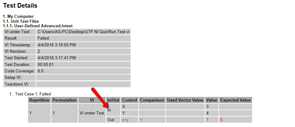

I'm trying to hide input parameters from HTML report of LV UTF.
According to requirement of project, input parameters in html report is not required.
I have attached test project to this post. Run "Run Test.vi" in project.

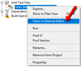

You can remove the input parameters from report by opening the *.lvtest file in 'External Viewer' (which is probably MS Excel).
Let me know if that helps
(3,027 Views)
Thanks LVK. Its really worked.
