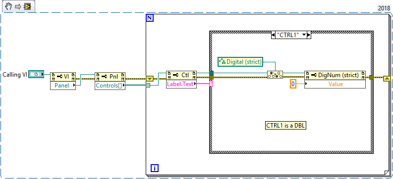

You can actually do this with only 1 reference sent to your subvi. If you send a reference to the calling vi then you can get all of the control references inside the subvi.
Message 7 of 14
It's too high-maintenance for me.  The way Raven described is much more automatic.  You don't need to know what to cast it to, and you don't need to know what the name of the control is.  Just unbundle and go.

@billko wrote:It's too high-maintenance for me.  The way Raven described is much more automatic.  You don't need to know what to cast it to, and you don't need to know what the name of the control is.  Just unbundle and go.
I like Raven's way as well, but it can still take up a lot of space on the block diagram if there are a LOT of controls that you have to make references to put into the cluster. Since the purpose is to initialize values you either have to have two cluster type definitions that you have to keep synchronized (one for the references and one for the initialization values, though the synchronization could be done by making each element be a cluster of reference and value) or you have to have a case for each control in the cluster. The type cast is actually not required for my approach, but I like to have the explicit type. Since the primary issue that Karlos Amigos was dealing with is real estate I was just offering this as an alternative to save even more real estate in the main.
Message 10 of 14
