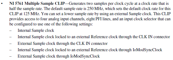

       I also wonder that the clocks in the NI 5761 Getting Started.lvproj are 40 MHz Onboard Clock, 200MHz Clock and IO Module Clock0(20 MHz), why it can take sample at 250 MS/s?

I have been looking into what you had mentioned and the Module should be running at 250 MHz and if you look at the example you will notice that each read actually produces 2 samples. That is who we can use the IOModClock which runs at 125 MHz when passed through the FPGA. The second portion of your concern deals with the FIFO and I am curious how you are reading from the FIFO. I am nearly certain that your computer will not be able to read from the FIFO as fast as that example is writing to the FIFO. In that situation you need to ensure that you are reading larger chunks of data from the FIFO in order to keep up. You are able to increase the memory associated to the FIFO on the host or the size on the FPGA but I dont think you should need to do that for this application. Please let me know what you think and which 5761 connector you are using.

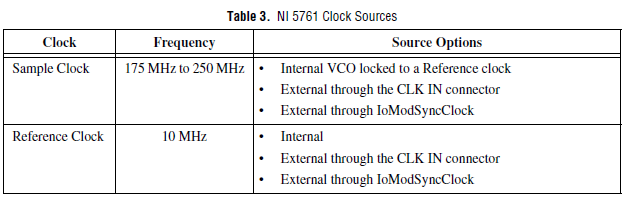

1. In the  NI 5761 Getting Started.lvproj, what is the purpose is using 200MHz Clock ? and IO Module Clock 0 is whether constant or defined by user ?  in this project, IO Module Clock0 is set to 20 MHz,is it correct?

1. The 200 MHz clock is used by the CLIP (VHDL) behind the scenes for proper data alignment.  It is required to compile the vi.  You do not need to do anything special with it beyond adding it to the project.  IO module clocking options are outlined on page 6 and 7 of the user manual.
To adjust IO module clock from internal to external, see the NI 5761 - Clock Select.lvproj in the labview example finder.

1) In the getting started project the loop uses the IO Module Clock 0. This refers to the clock that is running on the adapter module which gets passed through the FPGA for use in that loop. That clock runs at a clock rate to achieve 250 MS/s and when that clock is passed to the FPGA it is divided down to 125 MHz. In that case we would be running 1/2 as fast as the adapter module can produce samples. To overcome this, the FPGA I/O node is returning 2 samples at a time.
