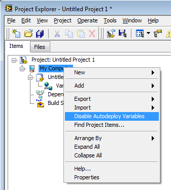

Hello Shall12,
You may need to select the "Disable Autodeploy Shared Variables" option for your host application space; without this the variables will be redeployed when your host application launches.

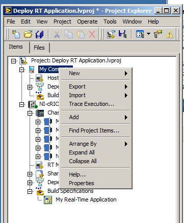

When I right click I get a different list.

Hello Shall12,
I misinterpreted your initial posts- this option needs to be modified for the target on which the variables are deployed.  Based on your screen capture, the library is contained on the RIO and will need to be modified there.  The behavior you're seeing is described in more detail here:
