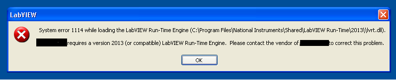

That is the error I get after I try to reopen the executable after it locks up (I had to black out the name of the program). This error only goes away after I reboot the computer. Then the program will run fine for a few more hours.
 Sometimes when this problem occurs the timed loops do not lockup. Sometimes the channels from the DAQ just stop updating and the program continues to run. When this happens all the channels on the DAQ are frozen. All the input channels stop updating and I cannot change the state of the control signals.
