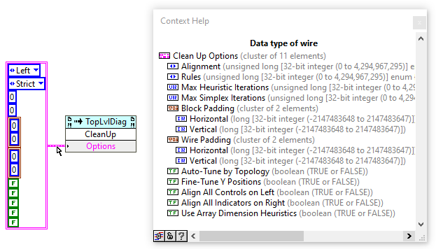

The TopLevelDiagram class has a cleanup method that takes options:
These are not exactly the same as in the LabVIEW options, so you'll have to figure out their values.

Just a little help to "figure out" the LabVIEW settings:
  • Use the library located here to read the LabVIEW INI C:\Program Files\National Instruments\LabVIEW 2021\resource\dialog\lvconfig.llb
  • Check the LabVIEW INI for the tokens. Unfortunately I could not find a documentation of the tokens, but look for ones beginning with autoLayout. They should be self explanatory with that cluster.
