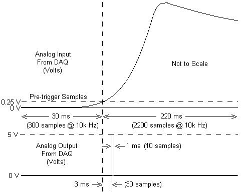

Hi I am working with a combustion chamber and using a DAQ system (with NI SCB-68 hardware) to read the pressure within the cylinder (as analog voltage). I am trying to output a delayed, 1-millisecond, pulse at 5 volts once the pressure within the cylinder has risen above 5 bar (which corresponds to an analog voltage of 0.25 V). I also want to record 30 ms of samples before the trigger and 220 ms of samples after the trigger. The following image visually shows what I'm talking about.Pulse Diagram.JPG

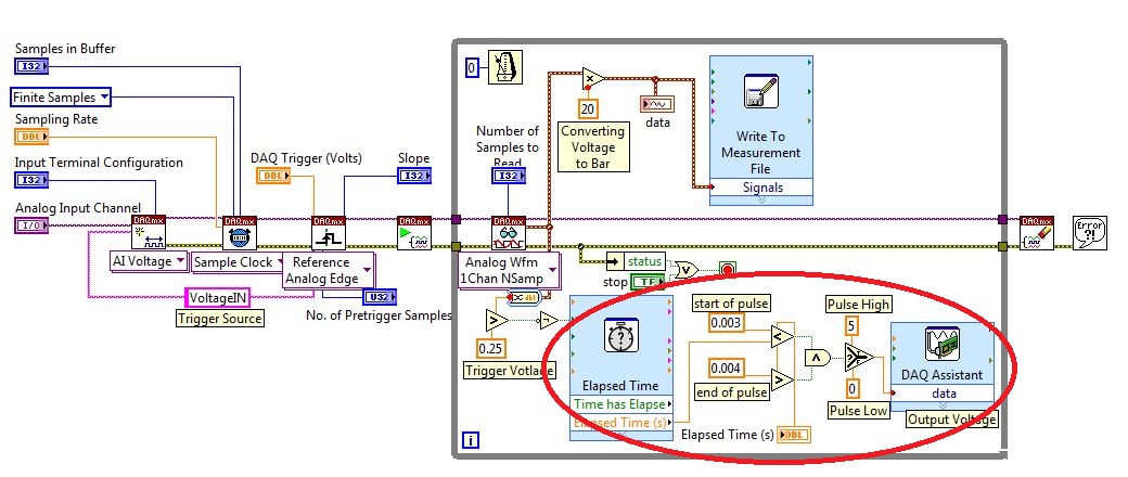

I have created a LabVIEW VI (which is attached) but I keep running into 2 problems:
  1. When I run it with Finite Samples after a period of time I get Error-200281which I don't entirely understand.
  2. Using the "Elapsed Time" Express VI to keep time for the pulse I cannot get a resolution of 1 millisecond, so the pulse is not generated when I set the window between 0.003 and 0.004 seconds for the pulse to be high (i.e. the resolution of "Elapsed Time" seems to be too coarse).

As far as getting a 1ms pulse inside that While Loop, I'm betting that is takes mroe than 1ms to iterate. The Elapsed Time VI can handle a 1ms increment, but you've got a lot going on in the While Loop, the Write to Measurement File VI is opening, writing, and closing the file each iteration.
(4,765 Views)
Thank you so much for your help! The explanation of the error code is extremely helpful and that makes sense why I am unable to get the 1ms pulse. Do you have any suggestions on how I mght be able to produce the pulse without using such a complicated While Loop? I really appreciate your help.
Use a DAQmx trigger to send the pulse when your acquired signal rises above 250mV like you specified.
See this for DAQmx Triggering:
https://www.ni.com/en/support/documentation/supplemental/06/learn-10-functions-in-ni-daqmx-and-handl...
(4,715 Views)
Thank you so much for the link! This is extremely helpful. I knew my VI was really inefficient but I wasn't sure how to clean it up. Also you were right before about the loop taking  too long to iterate. Even after I moved the "Write to Measurement" outside the loop it was still taking more than 17 ms to iterate.
