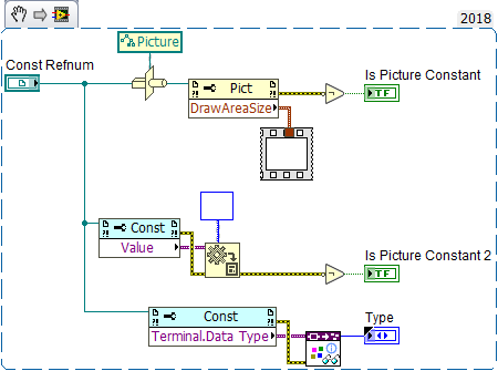

"Terminal.Data Type" property appears to work.

The class ID (16386) is not unique to pictures.  I now have 3 ways to check:

The cast to Picture VI Server class is a really interesting solution. I would have never thought to even try that.
