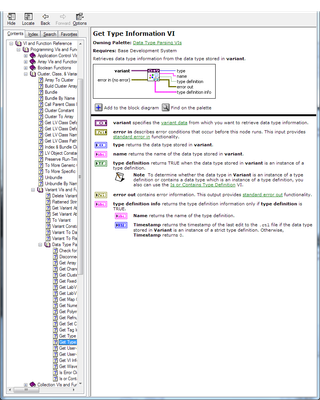

All you have to do is wire the output of each unbundled element into one of these guys:
This palette contains a lot of other things as well, and they may be even more useful to you than this one.
