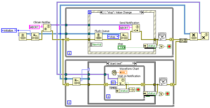

multiple pressings adds to the queue and it is still working on the extra "start test" in the queue, plus by pressing the "stop" ...you've stopped the producer loop. Add a "flush queue"...it should work or you can "enqueue at opposite end".

Yes.  Experimented with the "Flush Queue" myself! 😉
I have read in these forums about "Producer/Consumer" structures. I guess I'm now building one! If I understand the full operation correctly:
1. Pressing START causes the event structure in the producer loop to put a "start test" on the queue.
2. The state of the CASE in the consumer loop transitions from "initialize" to "start test" when the "start test" is taken off the queue. The "start test" case includes all of the work of the VI.
3. Pressing STOP flushes the queue (now!) and puts a "stop" on it, sends the abort notification, and stops the producer loop.
4. The abort notification ends execution of the "start test" case. The next execution of the Consumer Loop takes the "Stop" off the stack and transitions the CASE to the "stop" case, whose sole function in life is to flip the boolean input to the consumer's conditional terminal.

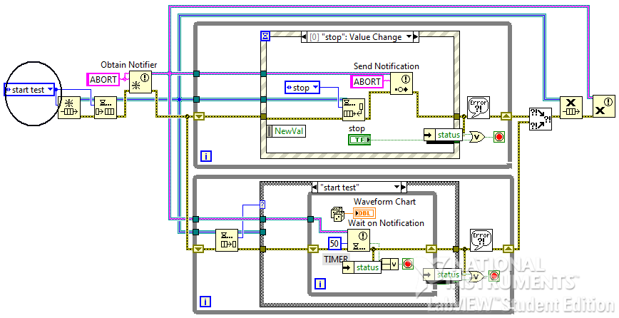

good to hear it helped...if you want to directly goto "start test", click on the enum that is "initialized" on the outside loop and make it "start test". As soon as you run the program, your test will begin. Also, you can delete the front panel control "start test." and delete the "event case" in the structure for that action.abort notifier ver8.5_BD.png
