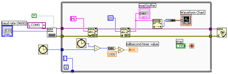

Hi Ratha,
                Iam attaching an example of a counter-Timer VI.This will be helpful for you to start with.Make necessary changes based on your requirement
                Hope this helps
Thanks as kudos only:)
(4,461 Views)
i slightly modified you vi..got rid of your "coercion dots" or "little red dots" by changing baud rate and byte count to an unsigned intergers and added your counterSmiley Happy
(4,444 Views)
(4,428 Views)

Thanks for helping apok,
My signal input is Pulse and I have tried your block diagram and I need to know it's can counting pulse input per round or per sec?
ex.riding bicycle
I need to count round of wheel per sec.
Thanks,  Ratha
