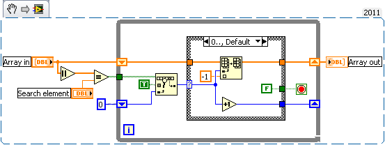

Let's clearify a little bit.  You start by saying all Inf values.  Then you say any values above a certain threshold.  Which is it?
If you are just looking for Inf, then I would use a While Loop with a Search 1D Array to find the Inf value, use Replace Array Subset to change the value in the found index to -1.  Stop the loop when the found index is -1 (not found).
If you want above a certain threshold, then you need a FOR loop to go through each element to check if it is above the threshold and then change the value.

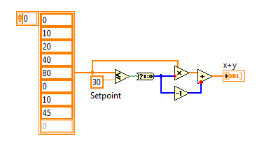

I would do that in this way.
If you want to check the values above a threshold just replace the "equal" with "greater or smaller" functions.

Personally, I would do something close to this (note: I did not really try to optimise anything)...

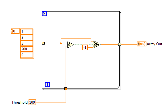

How abt this?
NitzZ

@crossrulz wrote:
Here's a simpler version...
Agreed Architect but you didn't show the threshold logic. I would consider Don_Phillips's logic more simpler
Message 9 of 12
(5,905 Views)
Yours didn't have a threshold either.  But I fully agree that Don's is the simplest.  I'm curious what benchmarking would show...
