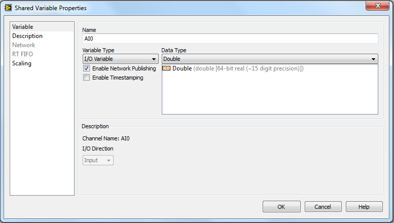

Any Shared Variable that has “I/O Variable” for its Variable Type (see screenshot of the Shared Variable Properties below) refers to any channel of data (such as Analog Input or Output or Digital Input or Output) directly from a module channel.  In other words, this is how you directly get the raw reading straight from (or to!) a specific module channel.
You cannot edit the Variable Type to Network Published.  You can check “Enable Network Publishing” as above, which allows this Variable to be accessed from a VI on a Host VI.  You could also create a separate Network-Published Shared Variable which you can wire directly to the I/O Variable on the Target VI if you wish.
