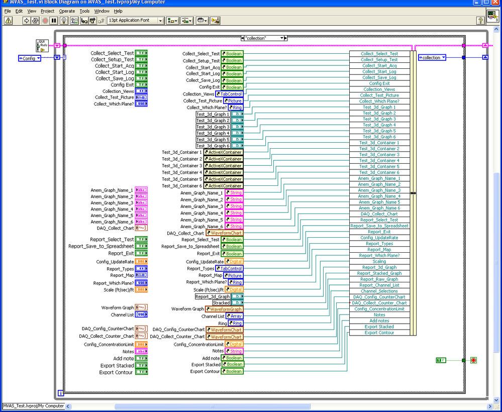

I am tryning to make a Subvi that has one output reconstructing of any selected control at top level  both the data type and the front panel control type (strict). While passing on references of top level controls to subvi's the datatype and the front panel control type are lost. These can be retrieved at runtime, but it seems hard to reconstruct them them at runtime at a lower level using only this reference. The point is, that it is a lot of work to copy and store these properties for all controls separately. The controls are there and fixed. I expect that at least in edit mode labview should be able to have a stealthy peek at what data type and front panel control type (will?) belong to the seleted reference and present the right data type at the output.

I have been dreaming of a solution that also restores the typedef. Not very succesfull as you can imagine. I surrender. It was not going anywhere anyway. Nevertheless I would like to share my project here, because there might still be some ideas in it that you might like.
