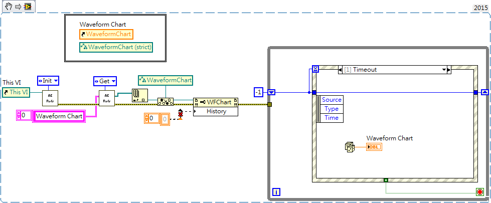

I made a sample to explain my question as clearly as I can.

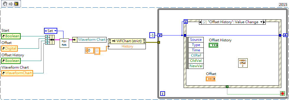

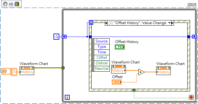

First I have a simple VI, it has a function only to add an offset to the history values of the waveform chart.
Since the program would grow largely one day, I'd like to make some modules or subVIs to optimize my code.
As a result, I merge all the control references into a cluster and make it to be a FGV, and then I can access any control property in a subVI(say "HistoryOffset2.vi") easily.
However, the program would grow largely one day, the number of controls and indicators would be numerous.
I don't want to merge all the control references one by one by myself, so I try to get "AllControls[]" references, and try to find what reference I want by an action engine.
Finally I got the problem...
I knew I could create a waveformchart(strict) constant by the waveform chart reference and connect the "target class" of the "More Specific to", it will work to get the History property, but I can't do it in the subVI.
Maybe the third method resulted from my stupid idea, however the most I'd like to know is how to access the control references among subVIs.

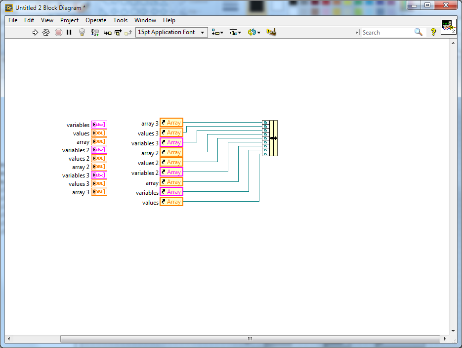

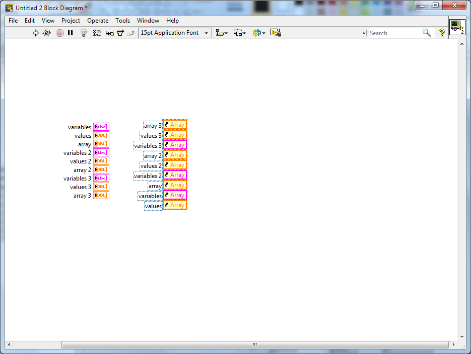

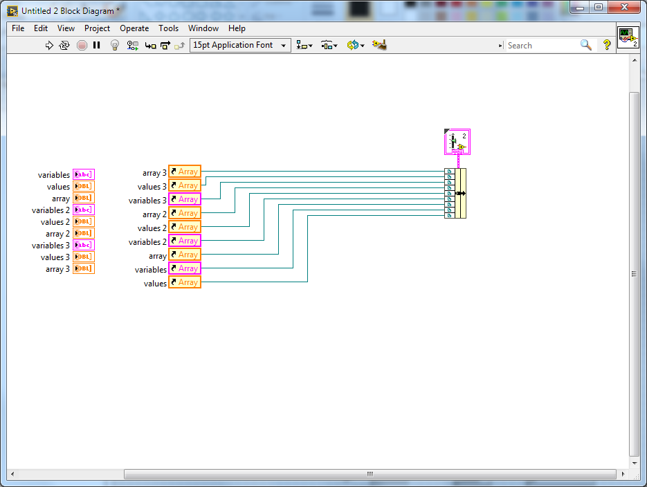

1) Collect the controls you want to reference.
2) select them and pop-up create references.
3) wire them all up to a bundle (not a bundle by name!) neatness does not count at this point!
4) Pop-up on the center terminal of the bundle and select "create constant".
5) pop-up and make the constant a type def. and views as an icon.
6) pop-up on the bundle and replace it with a bundle by name.
It probably took me longer to explain the process that it will take you to do it. Wire that cluster to any code that has to touch the GUI or to an Action Engine if you prefer.
