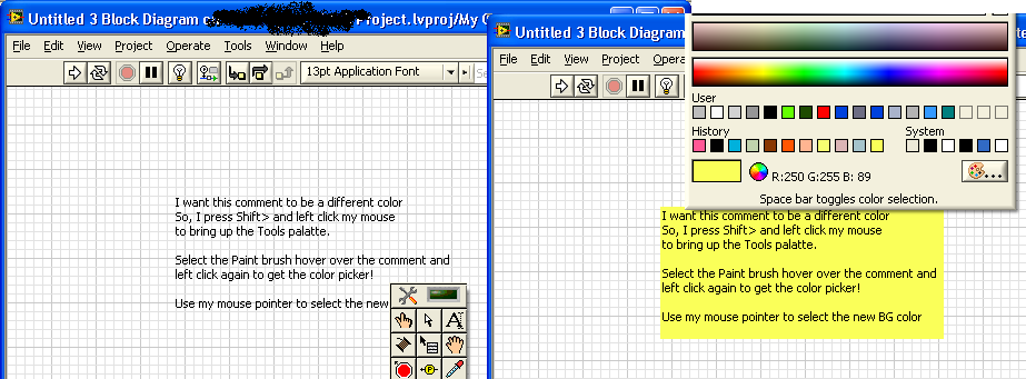

The tools palette has a coloring tool. Use it to change the background color (or anything else you like). :D.

That was simple enough... Thank you!

Shift, right-click for tools palette.
(3,643 Views)
Shift Plus The "F" finger
Bill is correct-
Darn-   Right   | Left (  I get them oopsied)  I really am better with E, W, N, S):smileyvery-happy:
