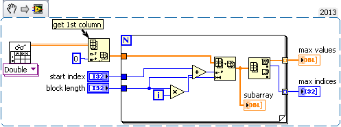

Hi John,
save that Excel spreadsheet as CSV file (form Excel).
The use ReadFromSpreadsheetFile to load the data into LabVIEW. Now you get an array of data and you can do anything with it.
- You might use a loop to pick an ArraySubset of each 1000 datapoints and analyze it.
- You might use numeric controls to provide an input for the user...
Where's your problem? It seems you already know where the goal is...
And try to THINK DATAFLOW! You don't want to analyze data from a graph, you want to analyze spreadsheet data. A graph is just a data sink (in LabVIEW)...

Hi John,
you should go through those free online LabVIEW 101 courses to learn how to use loops (and autoindexing) in LabVIEW...
Do you get the idea?
