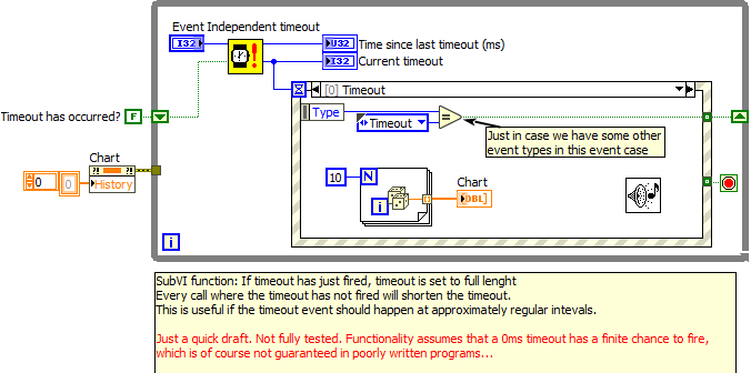

It is probably easier to do the dynamic timeout handling outside the event structure to keep things simple and not clutter every single event case. We also need to make sure that negative timeouts don't occur (e.g. if one of the other events takes a very long time). The attached modification (LabVIEW 7.0) incorporates these changes. 🙂
An updated, even cleaner version has been posted here.
