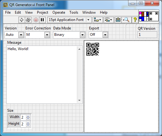

Here is some ancient code I wrote since I prefer G to C.
Message 4 of 10

I found out the right setting for the generator. I am sharing the generator and the reader is working for me.
I think my fault is data mode I chose alphanumeric in generation vi. When I chose Data mode Binary, reader vi started work.

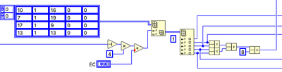

In "EncodeStrings.vi", I see this:
Is that "1" constant supposed to be wired to something?

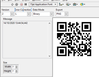

I've done some updating/cleanup.
