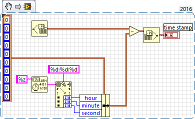

I extracted the following solution from here
Regards
Vinay
