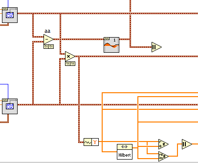

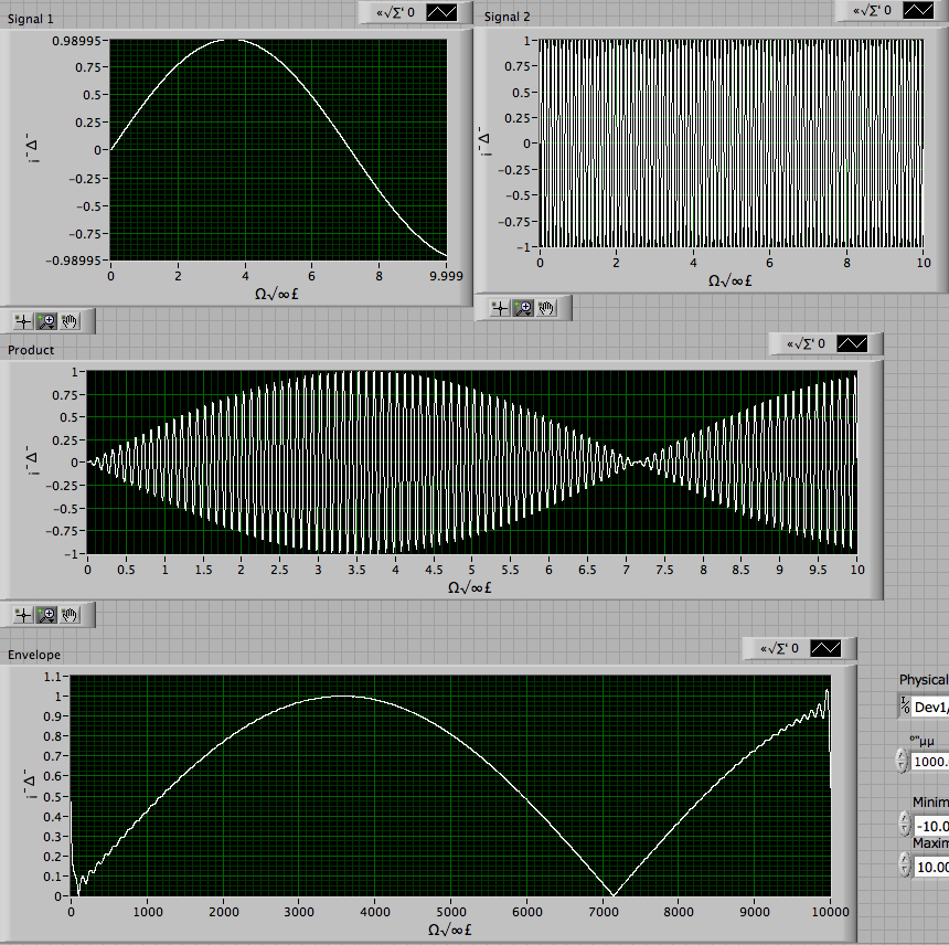

Two things:
1. Multiply your sine signal (with different frequencies), not subtract. That will produce a non-constant envelope.
2. Use Re/Im to Complex, not Polar to Complex.
Lynn
(4,818 Views)

I used the Diagram Disable structure to disable the DAQ VIs so that I could test the mathematics. If you wnat to run with your hardware, you will need to remove the Diagram Disable structures.
I also have some extra code to verify that Absolute Value correctly calculates with complex inputs. That is how I discovered that you had the wrong conversion to  complex. I changed some captions to make identification of graphs readable in English.
Lynn
