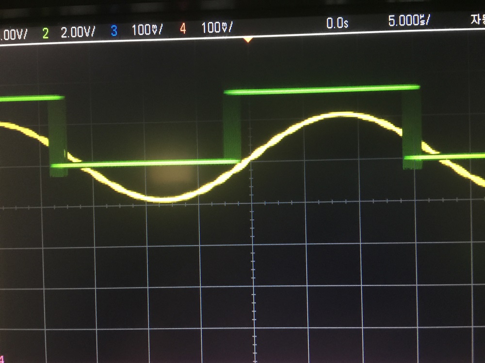

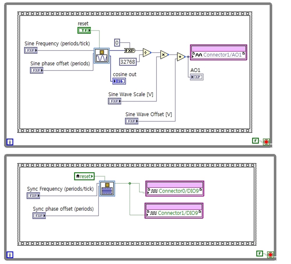

Like [1] below, when I try resettng two wavefom-generators, sine and sync signals are not perfectly synchronized.
And everytime I adjust sine's frequency, the phase difference between sine and sync changes arbitrarily

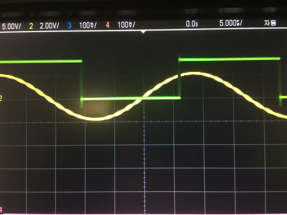

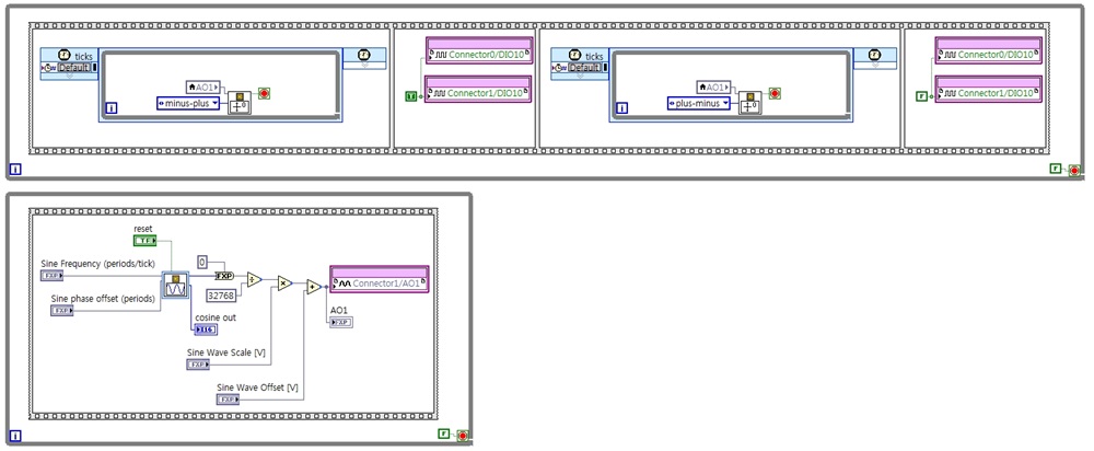

In case of [2] using 'zero-crossing detector', I have severe jitter of sync signals not suitable as 'sync' signals for other parts.

[1] Reseting two waveform generators
[2] Zero-crossing detect
