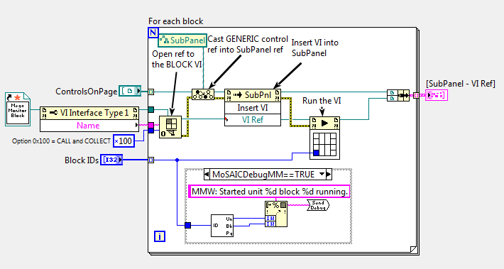

Well, I was already opening the thing  BY NAME.  That thread above showed that after he changed to BY NAME rather than BY PATH, the problem moved to the RUN VI call.
That seems to be what's happening here, too:
But it's already in a subVI, perhaps I can manipulate priorities there...
