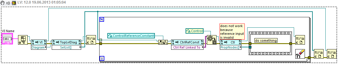

When I have the Reference (ControlReferenceConstant in Scripting), I can not get the Control the reference is pointing to. I guess it is done with the property "Control Reference Linked To". But I do not know how to convert the Variant to the Control. Converting it to the control class does not work. (See snippet below.) Conversion does not return an error, but the reference is invalid.
Some details: The variant does contain a Reference to a Control and has a matching name [2]. The data type of the reference is right as well [3]. But the reference is show as numeric 0, which is invalid of course (seen in probe and indicator).

The array reference is a control reference.  No conversion needed.  Its properties and methods are a superset of the control class, from which it derives.  You can downcast it to a control if you need a control type reference for an array or similar use.

If you look at the help for the property, you will see that it actually returns the data type of the node, not the actual control. That's way you can't use the reference in the variant - it's not an actual reference to a control.
I think this is simply an oversight in that no one added the relevant property to the node, but there is a simpler solution for you which I believe should work, which is to come at it from the other side - for each control on the FP, get the Control Reference Nodes[] property and search it for the reference of your node. If you found it, the node refers to that control.

You are right, it only is the type. Reading properly seems to be difficult...
I wonder what does writing the type. It seems to do nothing (except of raising an error if the control is from a different VI). Maybe this is not for references to controls but for "variable object reference"?
