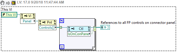

If you are talking about the controls being present on the connector panel, you can us a scripting property node to determine if a control is on the connector panel.
example-2_BD

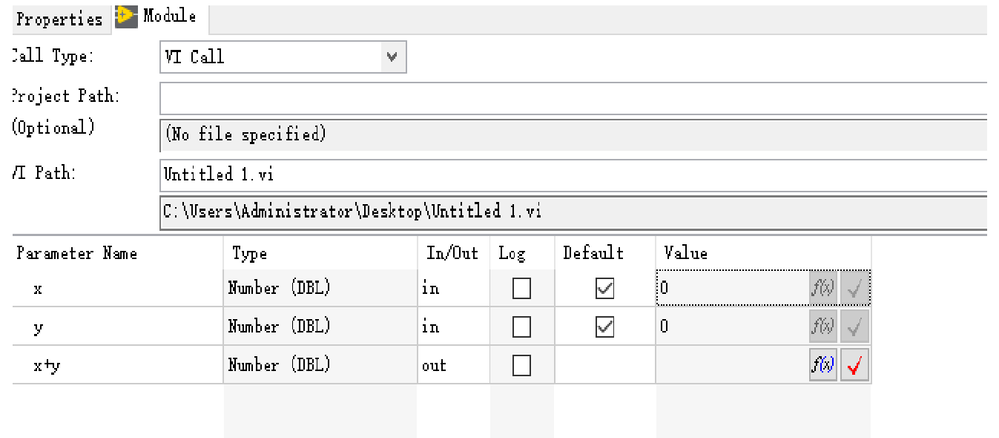

thanks both's reply, so sorry I didn't make the question clear.
I want to develop a function, the function can automatically fetch a subvi's input and output parameters and type, then I can config these parameters on GUI.
just like the labview module in teststand, if one LV vi loaded, the input and output parameters and data type are all displyed.

When calling a VI in TestStand, it will display all the input and Output Parameters[Parameter Name, Type, In/Out, Log, Default, value].
For each Input Parameter you need to assign Value/a Variable Containing Value for that particular Node.
For Each Output parameter you need to assign a Variable where the Value Needs to be stored for Future Scope/analysis.

You can create a VI to get the input and outputs of another VI's connector panel.  I showed you how to get whether a control is on the connector panel using a VI scripting node.  There is another property node that will tell you if it is an indicator (output of VI) or control (input of VI).
But you aren't going to be able to configure these on a VI.  You can't change between a control and indicator (actually you could, but you'll break that VI in the process).
