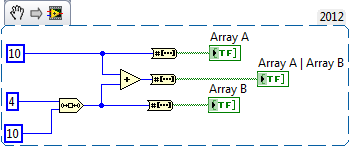

If you want the appearance of concatenating Boolean arrays in the manner that you describe, I believe you can also logical shift the numeric value for array B and then adding the numeric values of A and B together. Something similar to this:

Also, on second thoughts, if you're converting a number to a Boolean array, the resultant array is either 8, 16, 32 or 64 elements long depending on the numeric being converted.
So if you're concatenating A (32-bit integer to Boolean array) to B (32-bit integer to Boolean array) it may take some scrolling through elements to see the elements from array B 🙂

Hi ysma,
- you cannot convert SGL data directly to boolean array as the red CoercionDot is showing you...
- you still don't concatenate the arrays (despite all the comments in this thread) but instead create a 2D array...
Try this:
