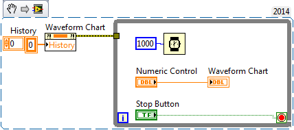

You should be able to restore the history just fine... this snippet I made works this way. The history is set and then new data is added in and it follows the history.
Cheers
