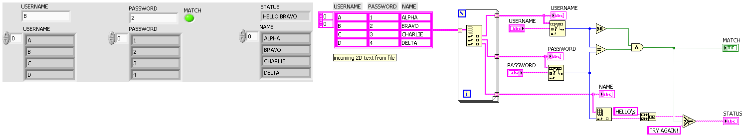

i would start by storing your multiple "username/password" in a 2D string file, read the 2D file and seperate into 1D usernames and passwords...do a 1D search on the arrays and compare if the element position matches, beware that the default index is -1, you need a # greater than/equal to 0 for a match.

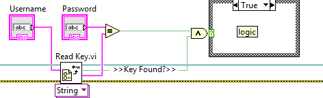

It requires a bit more understanding of the underlying file structure, but I'd suggest using configuration files  (.ini) to store username-password as key-value combinations.  This way you can query a username directly using the configuration file API rather than searching.
Any obfuscation or encryption would use nearly identical logic. Makes for a much cleaner code and scales better- you could even store users as sections rather than keys and track any amount of user-specific data (in this case, you'd use a "Password" or similar key under the user's section).  There are a large number of config file examples available on ni.com with a bit of searching.
