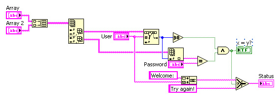

Hello apok, I have tried to make your .png file. How do you combine your 3 arrays in your Front panel to 1 array in your block diagram? I have made it like this. (see attachment). It is not working and I don't know why. Have you any idea.
Thanks anyway.

I don't know why the for-loop is used, so I left it out:
But as Hooovahh already said, you better make the username/password crypted.
Thanks anyway.
the 3 arrays were never combined on the front panel, it was made as a constant on the block diagram and seperated by the index array function (no need of a for loop? RubeG brain fart!). The 2D string array constant example was to be read from a spreadsheet file....
your example is indexing 3 arrays when you bundled only 2?....(please, no need of for loop. 2 yr. old example i had in my folder, must update)
again, this is used as a non encryptic example... suggest using outaw's .ini lookup as it is easier to implement (NI example under configuration file).  Smiley Wink
Oh now I see, I just checked the one from marijn: http://forums.ni.com/ni/attachments/ni/170/785580/1/Read%20from%20array.PNG
That's why I was confused, haha Smiley Very Happy
