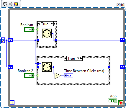

Woah!  Smiley Surprised
Sorry Apok, but your code is becoming way too complicated/messy. I don't think that all of those shift registers or boolean conversion/operators are needed at all.
If you want to measure the timing between two button presses then this is a different (much less complicated) way. It simply records the timing of the button press into a shift register then compares the two.
Spoiler
Time Between Clicks - Simplified
Of course this is a very quick and basic solution just to show you that it can be much simpler than you are making it (remember to use the mechanical actions of the buttons to get the behaviour you want).
A better way would be to use an event structure looking at value changes of the buttons to determine the timings between clicks.

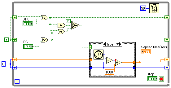

Try this. Substitute the boolean control with your FP Read. Note there will be some measurement error due to the FP Read overhead and non-deterministic OS.
The first rising edge "primes the pump" so ignore the first Elapsed Time and Frequency. This gives timing between adjacent rising edges, e.g., 2 and 3, 3 and 4, 4 and 5, etc.
