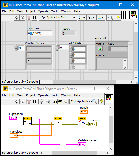

I suggest using muParser instead of trying to re-write the entire formula parsing library.
It is open source and it is pretty easy to add functions, constants, and operators if needed.
I've released a LabVIEW API for it here: https://lavag.org/files/file/295-lv-muparser/
