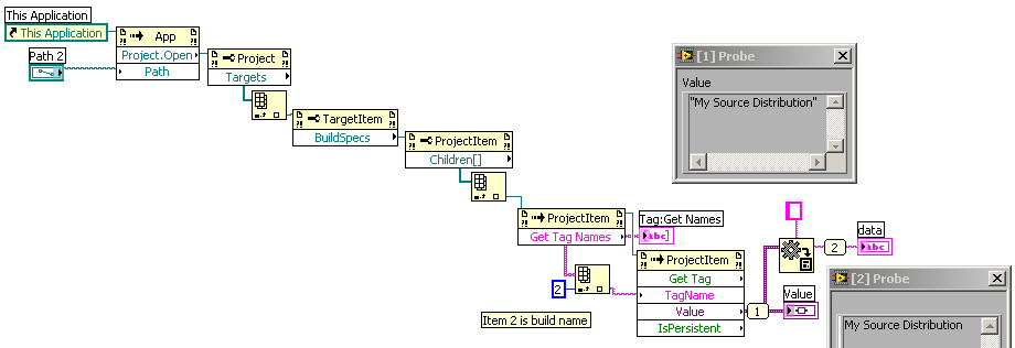

How can I programmably extract the project build information set in the project build specification. So I can then use the information in an ‘About’ dialog.
Extracting Project information

Do you mean something like this?

To retrieve specific items:

I did the examples quickly, so they are messy..
I simply wanted to know if that is what you meant by build spec parameters (info).  Or if you wanted to read the VI description for the "About" dialog.
The example does not show how to put the info into the About description.
Let me know if that was what you were looking for.

You can create a Application property "Project.Projects[]", or get the used project reference from a vi "Owning Application", and wire this to a property node "Project.Projects[]".
Then you have a project reference. Get it's root with a property "root" Then you have to get all "EXE" types, with the method "Get All Descendants" with "EXE" wired to Type.
From the "EXE" ref, you can use "Get Tag Names" and "Get Tag" to get (and, presumably, set) everything you want.
